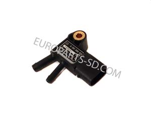

First the dealer was telling me that the problem is with this sensor:
http://europarts-sd.com/images/produ...6128_large.jpg
I tried to change it, but the problem remain

Do you know what the name is of this sensor?
And where is the place of this sensor?
JusticeNL is offline
Old 01-25-2013, 07:53 AM   #40 (permalink)
Points: 606, Level: 1 Points: 606, Level: 1 Points: 606, Level: 1
Activity: 3% Activity: 3% Activity: 3%
Car: 2006 Chrysler 300C 3.0 CDR
Join Date: Jul 2012
Member Number: 39561
Posts: 8
Thanks: 4
Thanked 5 Times in 4 Posts
the name is Exhaust gas pressure sensor
It's under the hood, not so far from turbo - in the right side, connected to the body with two tubes.
