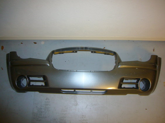

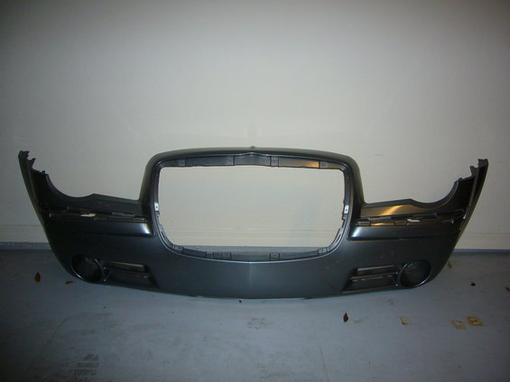

pics
Here are the pictures of the bumper. As you can tell its missing some trim below the headlights. Where can I find that trim (what is it called)?
