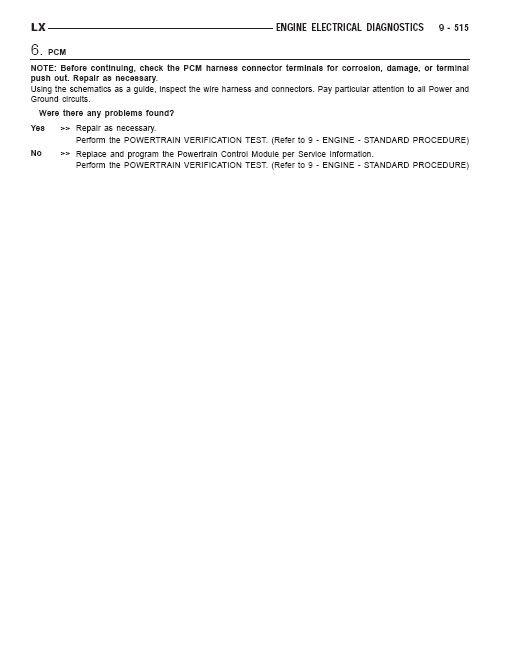

Here's the pages relating to that code. I'll have a look in the parts manual for the number & location. I have to be honest not much of this makes much sense to me, but for what it's worth...

I believe #7 is the sensor you're looking for.
