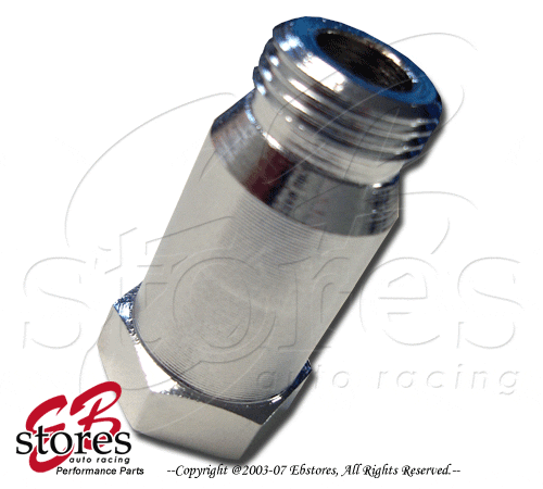

i have magnaflow hi flow cats and they throw the CEL. i think the code used to be 143
i put on some O2 sensor extensions yesterday and today CEL. the code is now 2099
just wondering if anyone has had any success with a fix for this.
PS. this is the extention i got from ebay, perfect fit but no fix. if anyone wants these for some reason let me know.

Used 3 of those on each side and NO CEL

Use atleast 2 shims per side.
