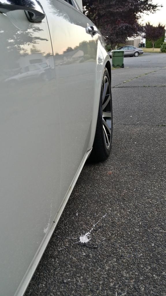

Slowly working on getting my ride to where I want it to be. Most recent modification is removing the standard Gen 1 badges and molding, and putting a Gen 2 wing badge on the rear.
After doing the trunk first, and having everything come off really easily, I was ver UNpleasantly surprised when I removed the molding from the doors. The double sided tape that held the door molding on was a ROYAL pain in the ass. Finally ended up getting a 3M eraser wheel, which I can highly recommend - finishing the removal process was a snap after that. Then worked it over with some cutting compound and finally waxed it. Came out really smooth - very happy with it.
