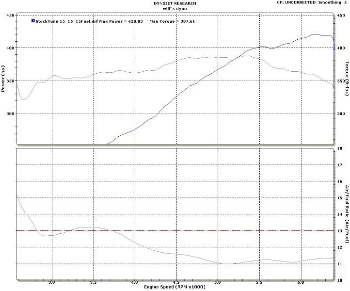

with a stock tune and adding fuel through the diablo. The 1st pull was with 15% fuel added across the board. I put it this way after the head and cam install for safety. I knew it will have the car running rich. I have Inertia motorsports heads and cam with kooks longtube with highflow cat, corsa catback, airhammer and running on the stock tune. The results are SAE corrected. Anyway here are the results...

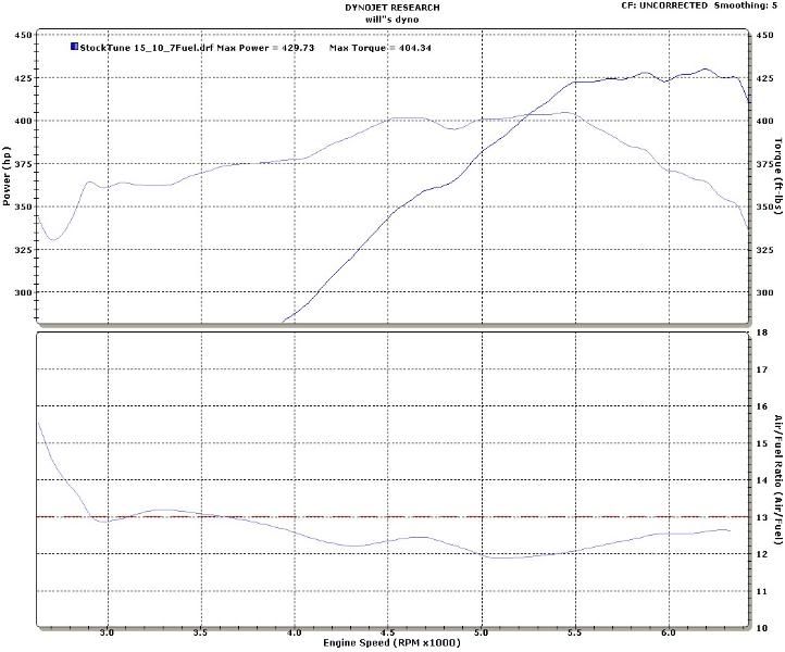

After seen the a/f I adjust it to 15, 10 and 7 percent. Here are the results....

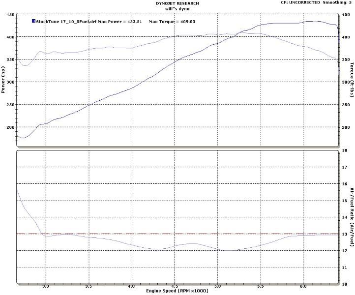

After analysing the a/f again I adjusted it to 17, 10 and 5 percent. Here are the results...
That's a nice improvement each time... lots of power range throughout the upper revs! Congrats.
