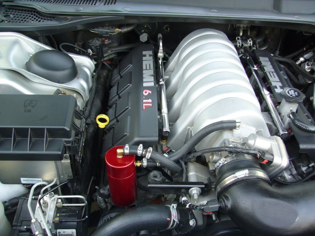

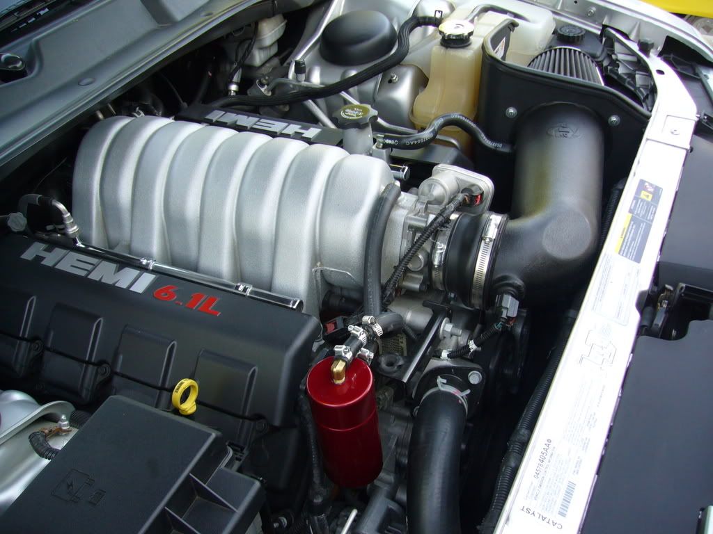

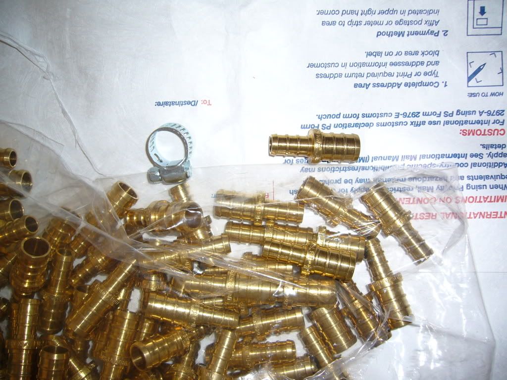

Here are some pics of the catch can I just finished. I bought an Elite catch can from a member here about a month ago. Didn't realize the Elite catch cans have 3/8" fittings and the SRT uses 1/2". So I finally found a 3/8"-1/2" coupler. So if anyone else needs these let me know. I could ship a couple to you for a few bucks to cover postage and the envelope (not trying to make money on them, just don't need a bag of them). Here are pics...

Why did you buy an entire bag of them?
Places like Homedepot, Lowes and Pepboys sell these things seperately,
where you can buy just one.
I made up my own catch-can for my 1985 Jeep CJ-7 last year using
some black PVC pipe and caps for the catch-can body, and I bought the
hose couplings from Homedepot, and I was able to get just the two I needed,
and they were sold seperately.
Just curious.
Jim
4,068 Posts
What is that mounted to to keep it up like that? I like that better than where the BT can mounts up, I feel like I am cooking my IAT sensor on hot days when I'm running the A/C and then the car is lethargic from a dig because it's pulling so much timing.
You may as well take off that mount for the intake silencer hanging off of your water pump bolt.

903 Posts
I've looked at Home Depot, Lowes, Do-it-center, wal-mart and so on for a 3/8"-1/2" coupler and couldn't find one. Plus the similar fittings are about $4 each. I found this whole bag on ebay for about $15 shipped so it was no big deal. That's why I'll ship 2 or however many for $2-$3 just to cover the minimal cost...
I actually bought it off Cam from Lxforums. He must have made up the bracket. I can ask him if you want some info on it, gotta go now, but I can email him later...
I don't want to lose that silencer bracket. I know, it looks lame.

4,068 Posts
I'm not saying throw it away or anything, just take it off and keep it with the stock intake. Show more HEMI :)

To solve your problem of relocating your Catch can you could reinstall your intake silencer braket with a hole drilled on the end. Then mount your can to the end moving it far enough away from the IAT sensor.
Maybe when I do my cam install I'll leave that braket off.
4,068 Posts
Good idea. I was thinking about drilling into the other intake tube AFE sent me, moving the IAT sensor to the bend of the tube and then filling in the original hole with something. Hmmmmm
Eric
