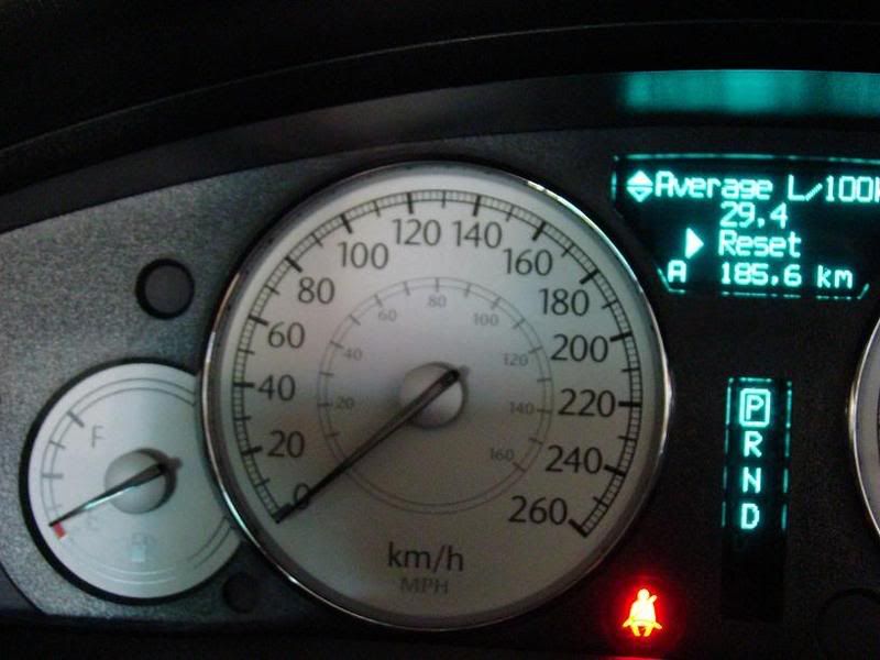

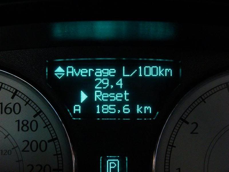

Had the car for a couple of weeks now, still working out how to use all the buttons on the dash but when I found this I thought I was on funniest home videos. Surely I should be getting more than 190km's out of a tank of fuel this can't be the norm with the 5.7i anyway I have spoken to Craig at Chysler AUST and he reckons something is wrong also, no fault lights on the dash, I was thinking one or both o2 sensors were faulty, waiting to hear back from my local Dealership here also. It's my first tank of fuel too and I drive like im driving Miss Daisy around also, car hasn't even been over 100 km/h yet :pat:

Like I said in your other thread about this, there are modules and sending cards for each side of the fuel tank. Sounds like one of them is bad. I'm betting you still have one side still full. The modules are under the rear seats. Someone else recently had this same problem.

I can see your angle Bernie thanks for the info, I will take it down to the Servo and refuel it when I can, hopefully the fuel tank is still half full otherwise I can see this sunday driving is going to be and expensive hobby :arms:

I am surprised someone else hasn't considered the excessively low average speed.
Work it out.
185 Kilometres
divided by
13 hours
= 14 klm/hr
That is a hell of a lot of standing and idling.
With the HSVs and Holdens in my past the trip gave you the average speed. My last Holden was a Supercharged V6 and that returned around 16 Lt/100 at an average speed of about 28 klm/hr.

Cheers John, thinking into it a bit more now there is no way in the world I have had driven the car for 13 hrs including standing/idling since I got it, I know there were a few electrical faults that the Dealership Rolfle Motors in Canberra fixed for me, I am thinking that they had the ignition on for extended period of times repairing it for me.

Ummm, not sue I see anything wrong in this last photo. The RH tank is used first and then the LH tank. The capacity is in the 180 - 200 range, therefore the trip would be telling you "low fuel" with those readings, which is right.

I could be wrong but I suggest that the reading of 29.4 litres per hundred represents real fuel going through the system and this is supported by the amount of fuel you had to replenish. I would be looking at major fuel leaks on the fuel pump side as I have had tow of them.
I don't think you guages are wrong!
