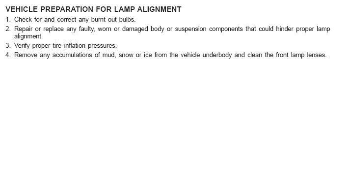

Seriously...any pics to these screws? I don't wanna go and unscrew the wrong thing!
4
Maybe this will help
Gary
:reporter:
Glorious... thank you!!!!! Now I can fix that annoying low left light. Or is it high right light? :D
THANKS A MILLION!!! This is why I love this forum and the second time I've gotten genuinely helpful info. I just aimed my headlights this morning and now they point at the proper height. I didn't have a long enough Torx screwdriver but used a small flathead that fit snugly in the threads. Like a charm!!!
