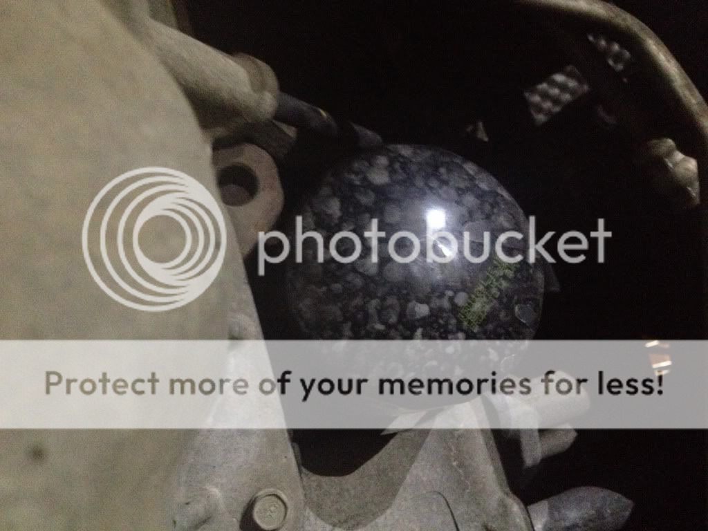

Ok, back to the oil change… Let all of that oil drain out nice and good, and then we’ll move on to the oil filter. You may have already seen it… it’s just to the passenger side of where you were just working on that oil drain plug. It’s tucked up there a bit high, but you will see that you have direct access to it. See it up there?

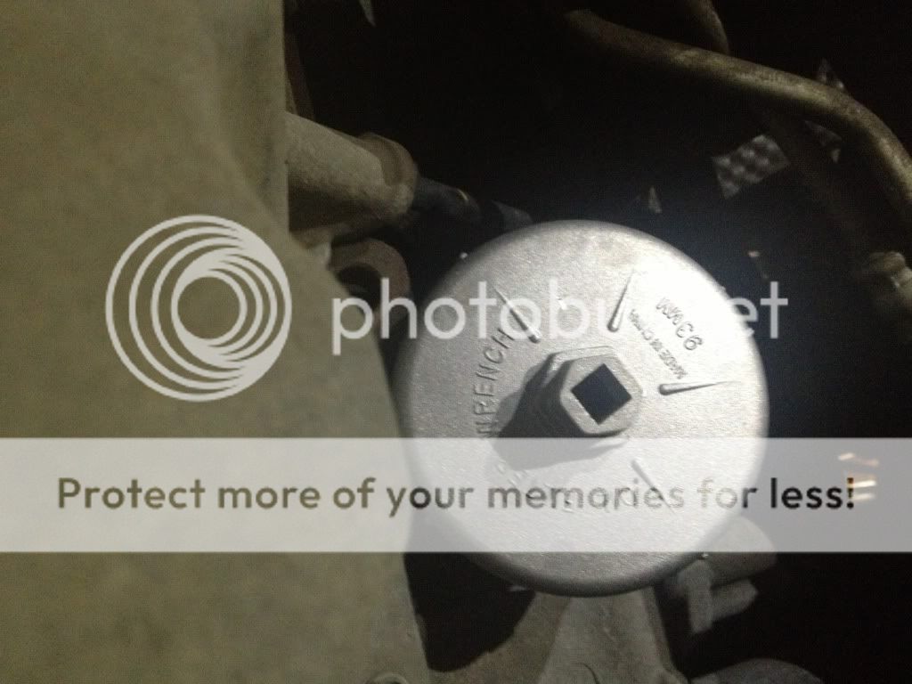

So get out your oil filter tool, whatever type you use, and slowly start removing the filter. Again, due to the location of our oil filters, I’ve found that these cup-style of oil filter tools work the best with a long ratchet extension since the bottom of the filter is so accessible. If the filter is on there good, I will use a mallet to bang the oil filter tool on there nice and tight and then begin to ratchet it off…
I should note that sometimes a good amount of oil will come out of the oil filter when it begins to loosen. I think this is just a pool of oil that is sitting just above the filter that doesn’t get drained – and when you loosen the oil filter it just comes out of that hole. I tend to slowly loosen the oil filter until that oil starts to drain out, and then I just let it run down the filter and drip into the oil catcher. This can get a bit messy. I’ve tried to remove it really really fast before, but that just creates a bigger mess. So I just keep slowly removing it and letting the oil drain down until I can fully remove it from the vehicle. Here’s a pic with the filter off…
Success!!! Now we just have to put this all back together. Screw on your new oil filter and tighten it with your oil filter tool. Replace the 13mm oil drain plug and tighten it appropriately. And replace your belly pan and the four 10mm bolts. Take notice when you are replacing the rear belly pan that it sits on top of the front belly pan - but if you look at the two corners in the front of the rear belly pan they will fit through a small slit in the front belly pan.
