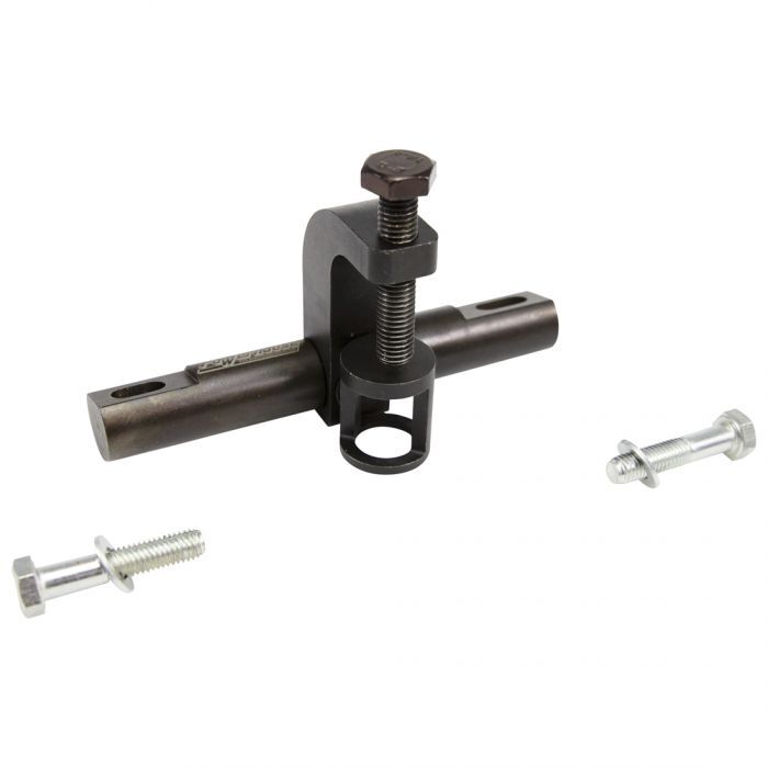

edit: This tool is the correct one for valve spring compression with the cylinder heads in place?
I have a generic valve spring compressor and an air compressor (although I think I'll need a fitting that reaches down as far as the spark plug). Was just thinking of carefully locking the intake valve in place with a bit of rubber and a small set of vice grips since I am leaving the exhaust ones alone for now.
Yep, that looks like a good one too. When I did mine about 10-11 years ago, the tools they had weren't that good. Be sure to have a some spare valve spring retainer "keepers" just in case you drop/lose one or two. Also, while doing the job, plug all the oil drain back holes and bolt holes that are big enough for one of them to fall into.
