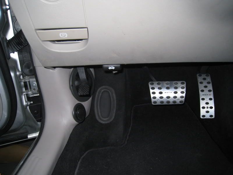

Hey guys, some of you have been following my install I assume. This is the latest part where I make a recessed amp rack in the spare tire well trimming out the Zapco DC650.6 amp. This amp runs the whole system and does it well. It is basically 200x2 for the front (bridging the first 4 channels), and its 500x1 (bridging 2ohm) to the subs for channels 5 and 6. The amp has an on board 10 band eq, crossover, bass boost, time delay for the speakers eliminating the need for additional pieces. There is a PC program you mist use to tune the amp, and a remote digital amp controller I put in the dash.
The front stage is a 3 way set Dynaudio 7", 4", 1.1" with a crossover, and the rear is 2xID10s in the rear deck. The sides of the trunk will be done shortly, hoe tomorrow.
Enjoy the pics.

Glad to see you changed the amplifier mounting location. How much clearance do you have with your Ebrake with your kickpod components in that location?
2,555 Posts
CLEARANCE? LOL not much... I have a couple inches
2,222 Posts
I kind of figured that lol but you did it and that's what counts. I know the guys/girls on CA forums have been watching your install especially after the infinite baffle setup you did with the rear deck:fing02:
