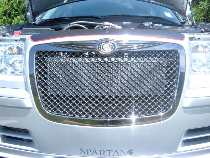

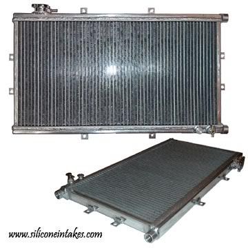

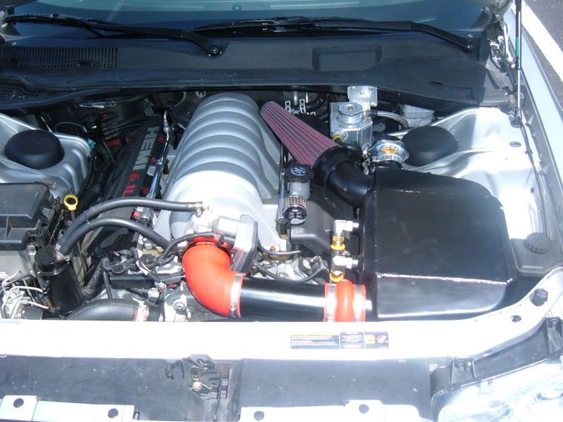

I installed and plumbed my intercooler and fit a filter on it for now till I finish the rest of the system. The heat exchanger is 24x12x1 mounted in the grill. The electric coolant pump is mounted in the lower drivers side fender area. It is currently cycling the coolant, so as of right now I have an intercooler intake:cold: Performance seems about the same as my ram air but quieter.

Yeah this intercooler is for the turbo setup I am finishing up. The filter on the intercooler is just to hold me over.

Wow, you made this setup? I know you didn't make the filter but this is your design?
I bet that 6.1 will take well to the turbo and you should have some serious fun with that car once you get it all going.

When I design turbo systems I want the least amount of system volume as possible to make it as efficeint and responsive as possible. Also liquid/Air intercoolers can be more efficient at cooling then air to air specially if I add an ice box. In my case I don't want the excess plumbing and volume by running piping into the grill to a large capacity intercooler.

Probably because it won't fit there so used a thinner core! Maybe

So do both turbos feed into the underhood box or do they y together somewhere.
