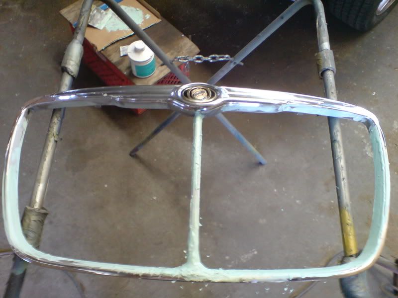

For awhile now I've been saying I was going to make modify another OEM grille just like I did when I made the "mini" deep dish, but with a center bar this time around. I didn't find it very difficult for me, but it's taking me awhile with school and other things I need to do first. Thought I'd share on my process so far, just needs a little more bondo/sanding and it'll be ready for paint. This time I did the bondo, it's easier to use than I thought :pat: .

To fill the back side of the center bar and holes from the cutting I used JB Weld. Then I used bondo to cover everything up after. The bondo I'm using is Evercoat Metal Glaze. I've never used bondo before, wasted a bit of bondo because I kept mixing too much hardner lol.
*Few updated Pics:
Having hard time getting the shape on the bottom here. :lick:
