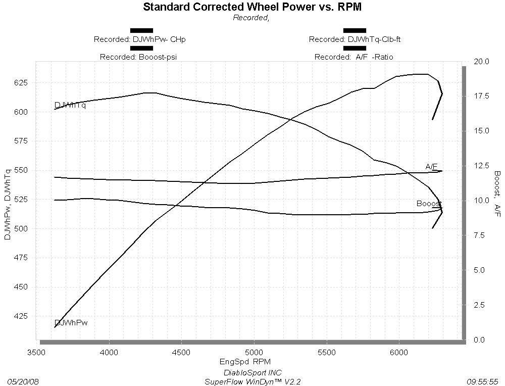

Car started life as a Chrysler 300c 5.7L and now has the following.
PPP/Arrington 426
PPP Stage 2 Heads
PPP 426 Twinscrew cam
Longtubes
Catback
RDP Blower
Custom tuning by Steve at RDP and Johan at Diablosport.
9PSI
No Intercooler
No Water/Meth
No Add-on Boxes
100% CMR tuned with Diablosport
Oh yeah, they aint done yet.

Our motor carries a 3 year/36,000 mile warranty. Everyone has an opinion on what they feel is accaptable. They dont like the 426, I dont like that they (SRT) put a forged crank in the motor with cast rods and cast pistons that fall apart easier than a KIA. I would be willing to bet our NA 426 would last longer than their NA 6.1 on a simulated engine dyno. The bores are .025" bigger than stock, thats .0125" worth of material removed. If they are worried about that, then they need to be worried about the stock bore also. They should be more concerned with the core shift in these blocks. Each block that comes in gets the bore centerlines validated and 9 times out of 10, the bores are not centered which causes thin spots and cooling inefficiencies. Now I know they are not building a HI-PO race motor, but they could do a little better. Its all in the tolerances, if you build a loose 426, it isnt going to last long. The one specifically in our car has 36,000 miles on it now and 70% of those are at wide open throttle and/or sideways. lol.

The core for the manifold only arrived on Tuesday this week. I believe that will be sorted soon. Winding it up to 15psi once installed. Should go close to 800rwhp no probs.
The blower itself; a Harrop HTV2300 has extremely low discharge temps hence why this was used above all other tested blowers. There isn't a lot of realestate under our bonnets so this blower was of course the perfect choice. At 15-20psi this motor will be a killer.
The only problem with it all though is that it very easily lights up the back tyres in 3rd and 4th gear.

Things should be wrapped up next week. Once all of the numbers are in, I will post them and show you what we ended up with. I have video, that shows how quickly revs build. She is a amazing to watch on the dyno..... Need to find a track open.
PS, it was 96 degrees and over 85% humidity on this run.
