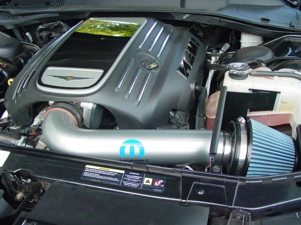

Here's a pic of chasb's Mopar intake:

If the filter is "up" in the engine compartment... isn't it that blue cone-lookin' thing-a-ma-jig to the right in the pic?... how is it getting "cold" air vs. "under hood" air? Just curious. Doesn't the Volant have a "snake" that actually goes down to cool are near the bottom of the car?

Yes Tim, the Volant uses the front dam for air intake so is theoretically taking in cooler air.
