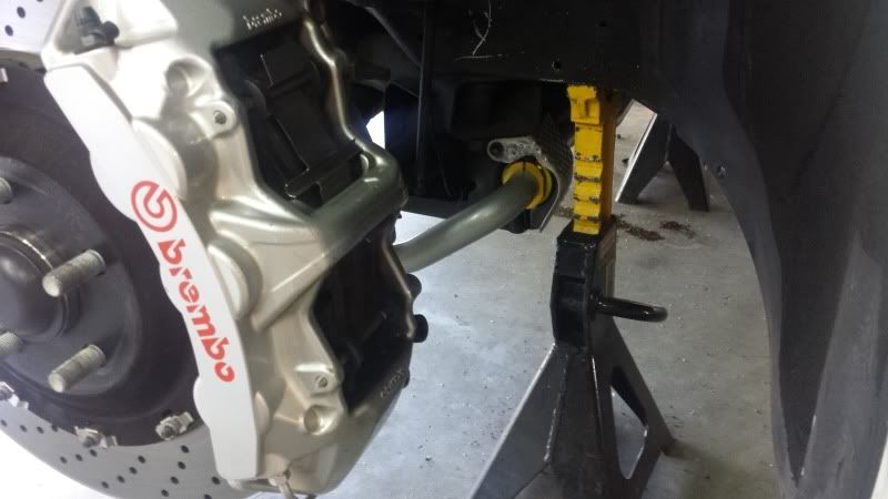

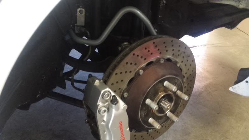

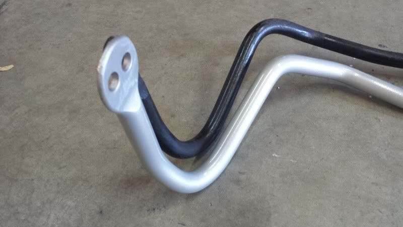

We installed the Whiteline Suspension sway bar kit and Bump Steer on fatchance 2.0, this kit is incredible and very complete. The stock sway bar is 30mm front and 15mm rear, the whitline bar is 32mm front and 18mm rear. The install is straight forward, and the fit and finish are on point.
Front sway bar comparison:
Rear sway bar comparison:
Front complete:
Rear complete:
